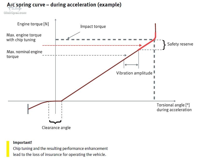

Uite si ce face chip-tuningul, tot de la amicii astia Luk:
Chip tuning is a quick, easy and fairly inexpensive way of increasing engine power output. For a relatively small amount of money you can easily increase the power of an engine by up to 30%. Facts not normally considered are whether the engine is durable enough to withstand the higher outputs, e.g. thermal overloading, and also if the rest of the drive train can withstand the increase in torque/performance. Usually the torsion damper system of a Dual-Mass Flywheel, just like the remaining parts of the drive train, is designed for the engine for which it is intended. In many cases the safety reserve of the Dual-Mass Flywheel is used up or exceeded by a torque increase, sometimes by more than 30%. As a consequence, the arc springs can already be completely compressed during normal driving, which deteriorates noise insulation and can cause the vehicle to jolt. As this is the case at half of the firing frequency, very high loads are quickly produced and transferred not only to the Dual-Mass Flywheel, but also to the transmission, which could result in damage to drive shafts and the differential. Damage can range from increased wear to a catastrophic failure resulting in a huge repair bill. The operating point of the Dual-Mass Flywheel is shifted towards its security reserve by the increase in the power of the engine. During driving, the Dual-Mass Flywheel is permanently overloaded by the higher engine torques. This causes the damper springs in the Dual-Mass Flywheel to operate “fully loaded” more often than they are designed to and can destroy the Dual-Mass Flywheel! It is true that many tuners give a warranty on the vehicle when increasing power output. But what about when
the warranty period is over? The increase in output can damage other components in the drive train slowly but continuously. Sometimes these components will fail at a later date (after expiration of any warranty given!), which means the repair costs have to be paid by the customer.
