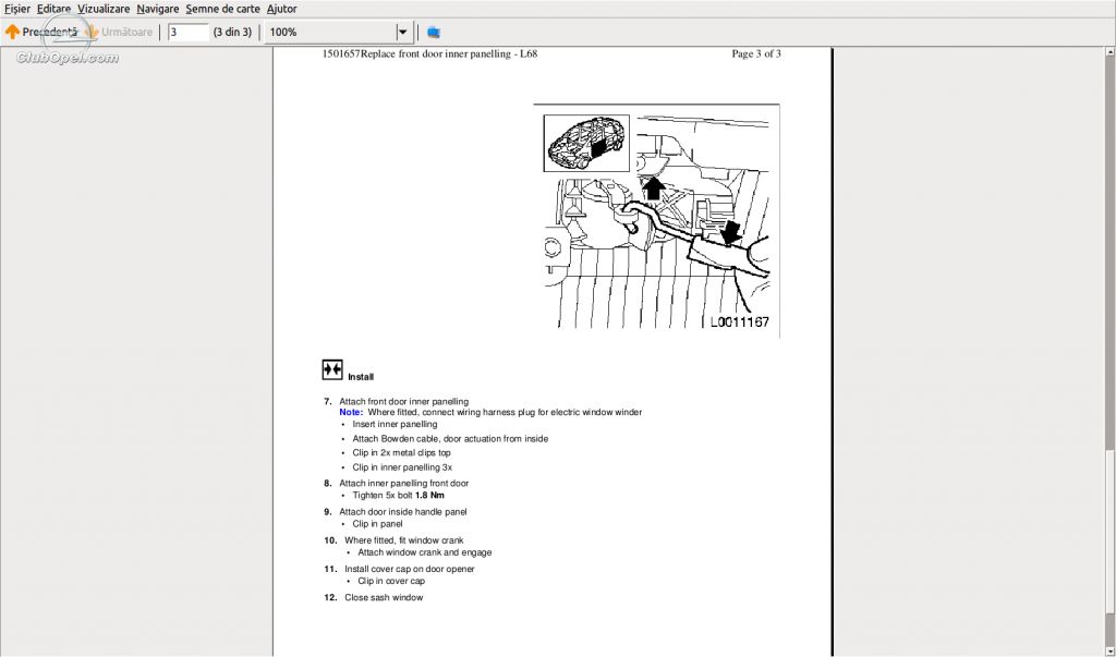

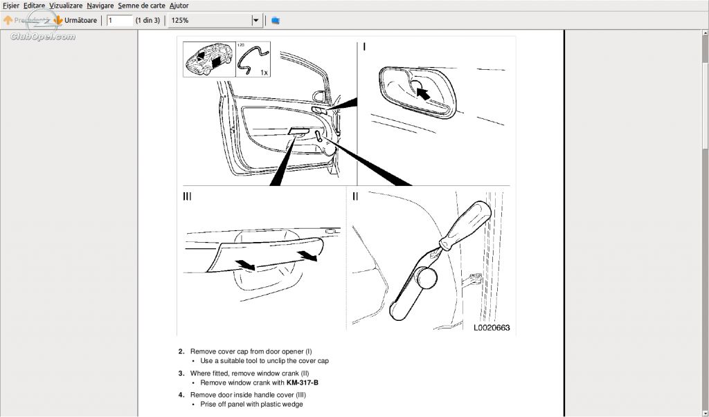

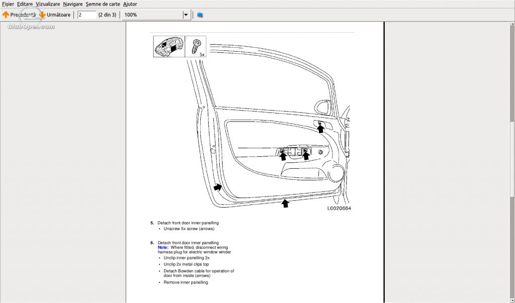

1501657Replace front door inner panelling - L68
Remove
1. Lower sash window
2. Remove cover cap from door opener (I)
• Use a suitable tool to unclip the cover cap
3. Where fitted, remove window crank (II)
• Remove window crank with KM-317-B
4. Remove door inside handle cover (III)
• Prise off panel with plastic wedge
5. Detach front door inner panelling
• Unscrew 5x screw (arrows)
6. Detach front door inner panelling
Note: Where fitted, disconnect wiring
harness plug for electric window winder
• Unclip inner panelling 3x
• Unclip 2x metal clips top
• Detach Bowden cable for operation of
door from inside (arrows)
• Remove inner panelling
Install
7. Attach front door inner panelling
Note: Where fitted, connect wiring harness plug for electric window winder
• Insert inner panelling
• Attach Bowden cable, door actuation from inside
• Clip in 2x metal clips top
• Clip in inner panelling 3x
8. Attach inner panelling front door
• Tighten 5x bolt 1.8 Nm
9. Attach door inside handle panel
• Clip in panel
10. Where fitted, fit window crank
• Attach window crank and engage
11. Install cover cap on door opener
• Clip in cover cap
12. Close sash window
