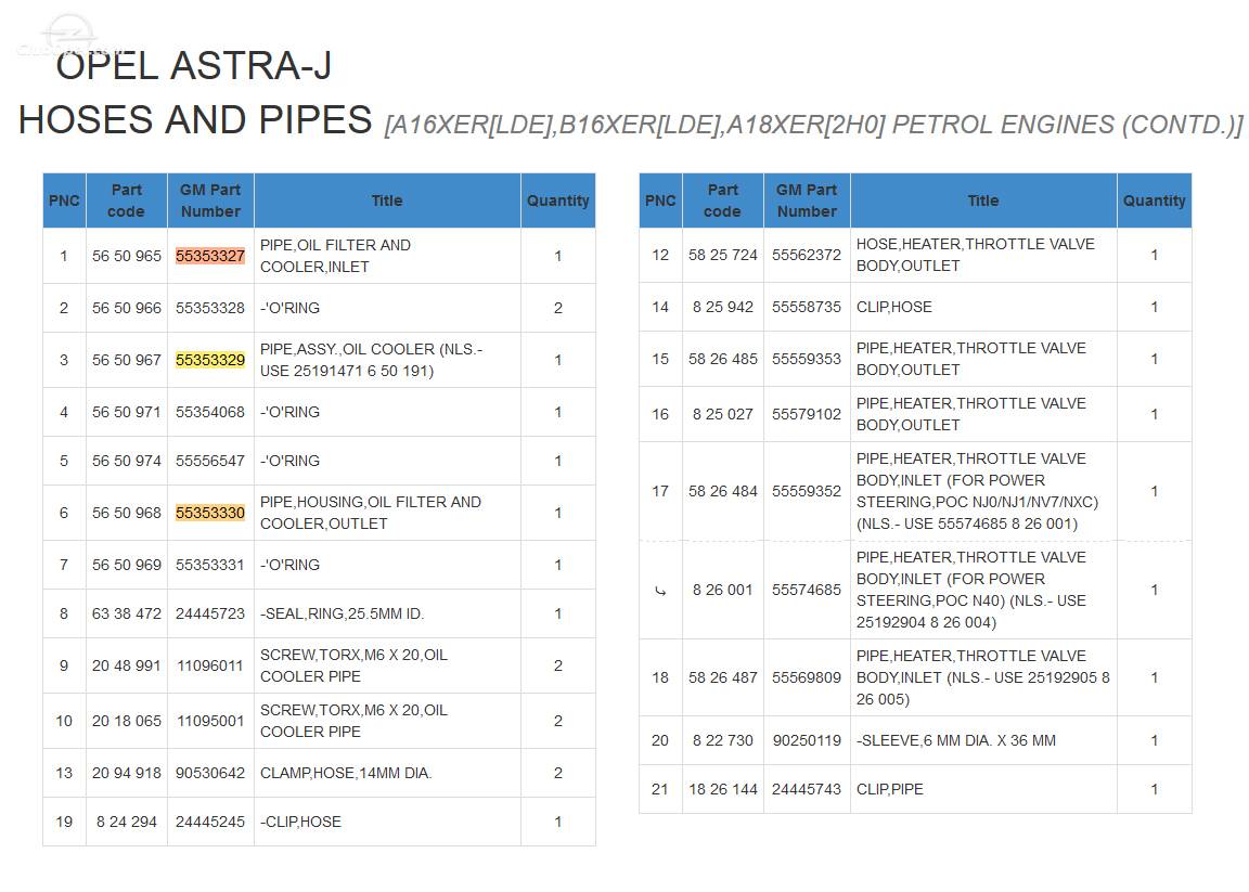

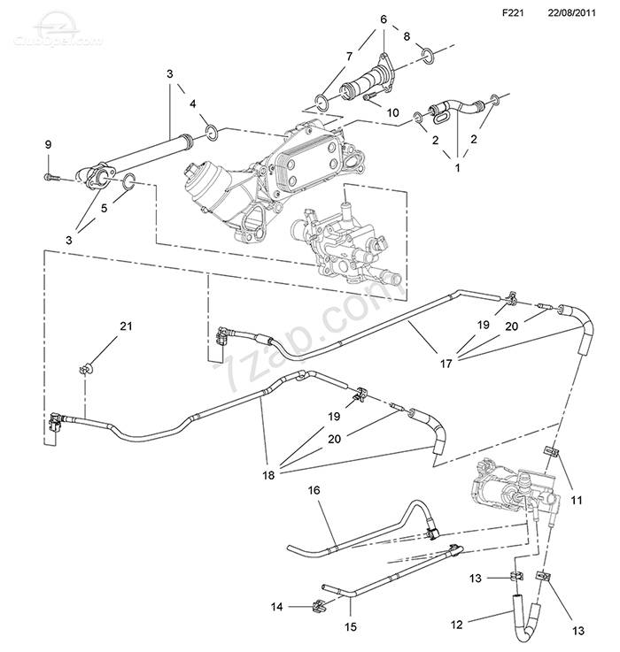

Daca are scurgeri poate trebuie schimbate doar oring-urile.
OPEL ASTRA-J -HOSES AND PIPES [A16XER[LDE],B16XER[LDE],A18XER[2H0] PETROL ENGINES (CONTD.)]
1   56 50 965   55353327   PIPE,OIL FILTER AND COOLER,INLET
3   56 50 967   55353329   PIPE,ASSY.,OIL COOLER (NLS.- USE 25191471 6 50 191)
6   56 50 968   55353330   PIPE,HOUSING,OIL FILTER AND COOLER,OUTLET
https://opel.7zap.com/en/car/p10/f/0/27-1/

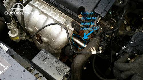

Are scurgeri mici. Dimineața gãsesc o pata. În timpul zilei cand merg cu ea nu vad nimic.
