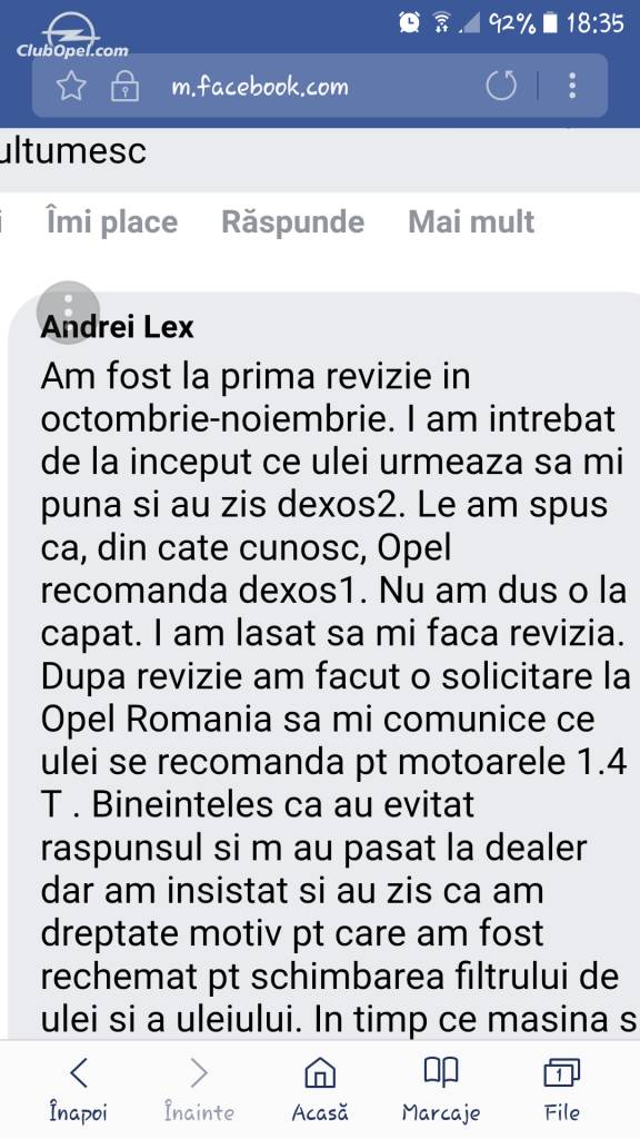

Iata cele redate de coleg care poseda o astra j sedan 1.4T
