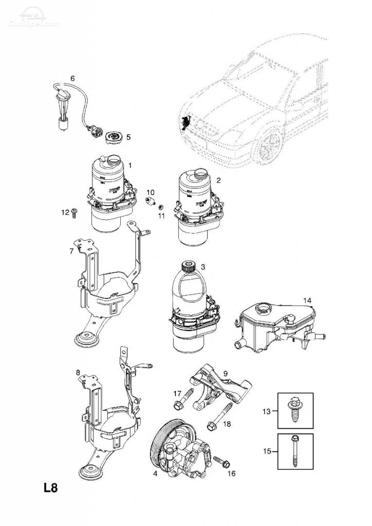

http://www.ecat24.com/opel/...1/456/4383/41557/
http://www.ecat24.com/opel/...4383/41555,41556/
Ce motor are masina ta?
04 https://postimg.org/image/recxbh8ep/

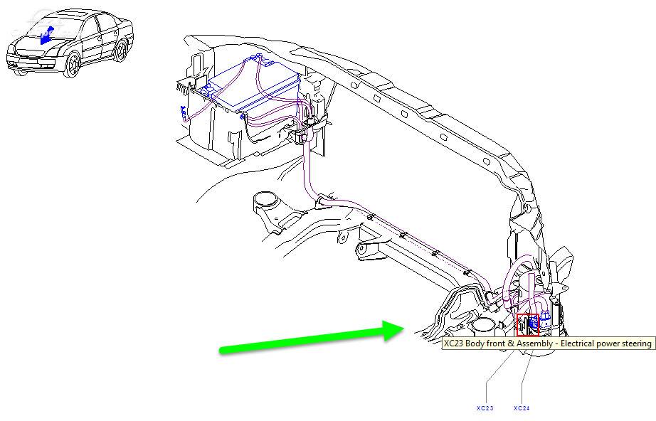

04 https://postimg.org/image/ezsfzr6dd/
00 https://postimg.org/image/rq19qkvzb/
01 https://postimg.org/image/un6px657l/
01 https://postimg.org/image/9qum5ykcn/
02 https://postimg.org/image/725bwhmpz/ - Sigurante
03 https://postimg.org/image/7mla253lz/ - 12v cred ca de pe borna de +

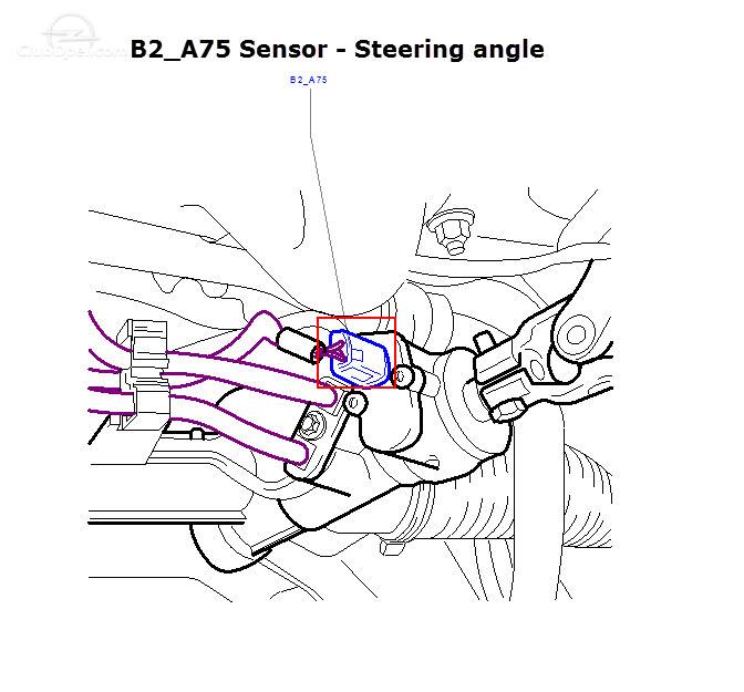

B3_A75 Sensor - Steering fluid level (daca are asa ceva probabil are si un vas am zis eu nu sunt sigur.)
Aceste doua nu stiu ce rol au.
HSCAN-H High speed CAN-bus - High
HSCAN-L High speed CAN-bus - Low
B2_A75 Sensor - Steering angle - nu stiu ce este.
B2_A75 Sensor - Steering angle - nu stiu ce este"... HSCAN-H/HSCAN-L,este vorba de comunicarea pe magistrala CAN de viteza mare,iar B2-A75 este senzorul ce supravegheaza si comunica la calculator, unghiul volanului(prin CAN)...
