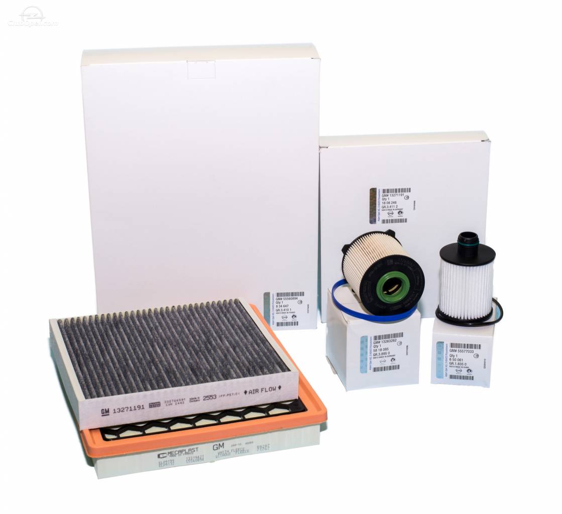

Filtru aer GM: producator Mecaplast, made in France, are doar 43 mm fata de 52 mm la Mann sau Mahle, si nu mai are pasla aia, deci clar nu merita OEM;
Filtru combustibil GM: producator Hengst, made in Germany;
Filtru ulei GM: producator Mann, made in Germany;
Filtru polen carbon GM: producator Mann, made in Germany.

Pe original filtrele de aer vad ca sunt si cu si fara pasla cu coduri diferite (with/without fleece)
