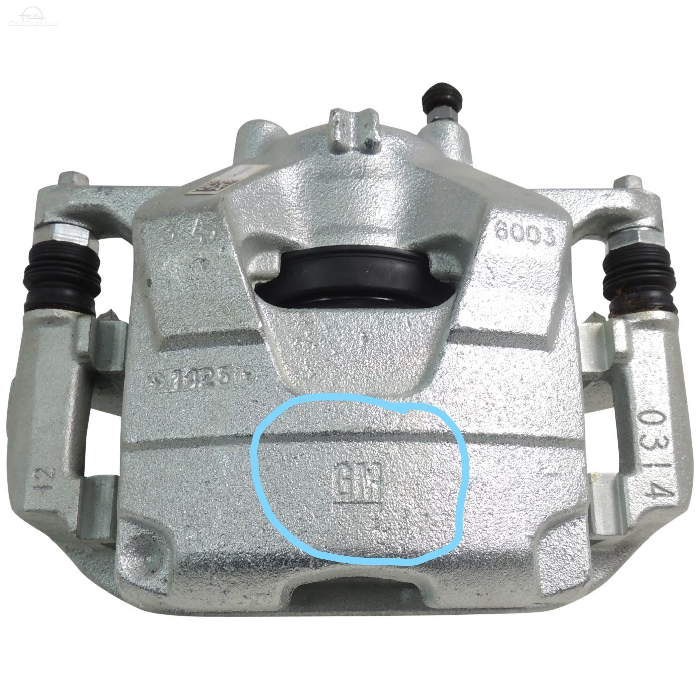

Fatã
GM 13597460 Disc, front brake, 276mm dia.
GM 13478300 Kit, friction linings, brake, asbestos-free (nls.- use GM 39103797)
GM 95526566 Kit, Friction Linings, Brake, Asbestos Free (Aftermarket Specification).
Spate
GM 13509119 Disc, rear brake, 264mm dia
GM 39037199 Kit, friction linings, brake, non-asbestos
GM 95526568 Kit, Friction Linings, Brake, Asbestos Free, After Sales Specification.
Cam așa...
Spate
Cam așa...
