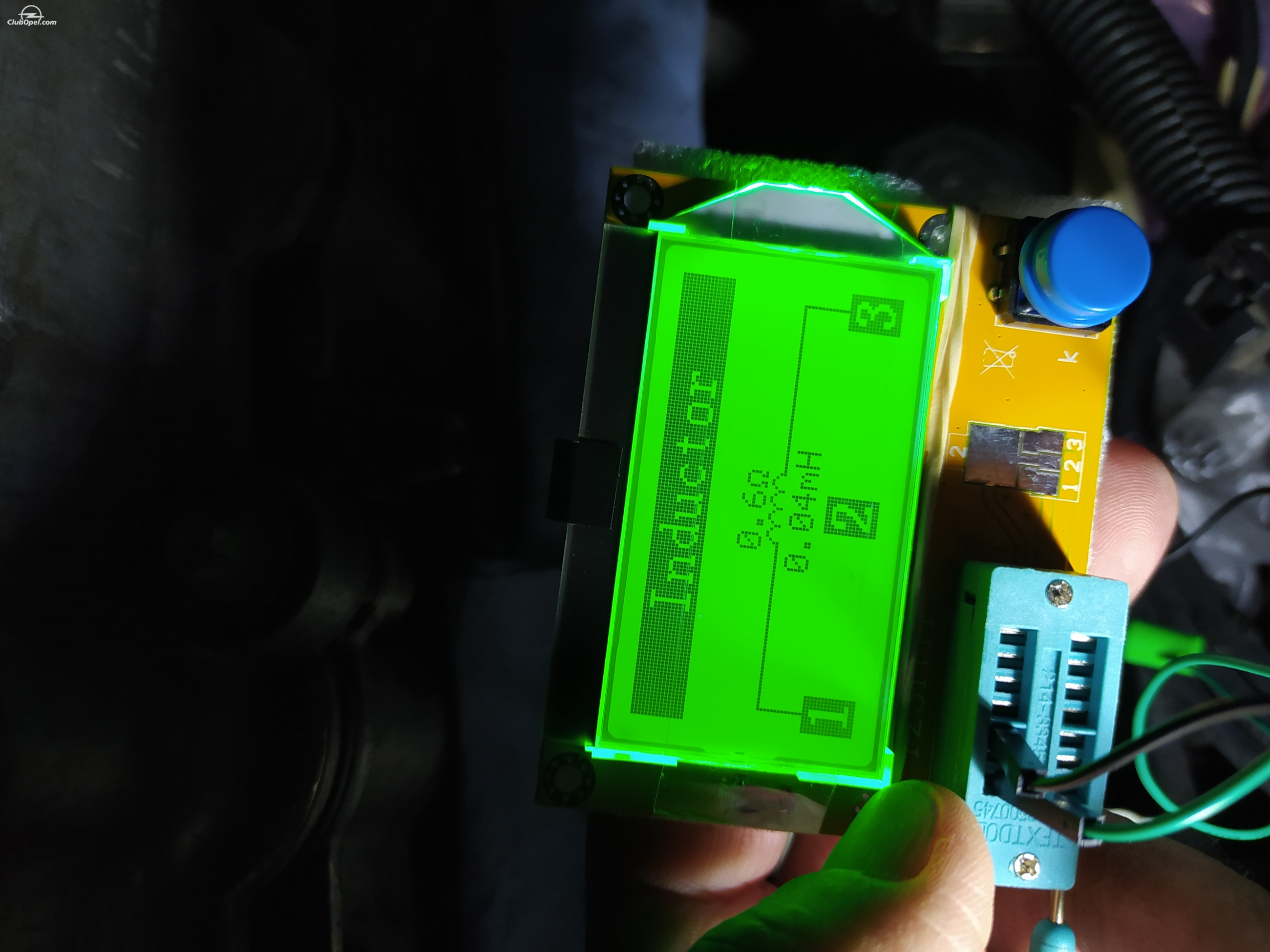

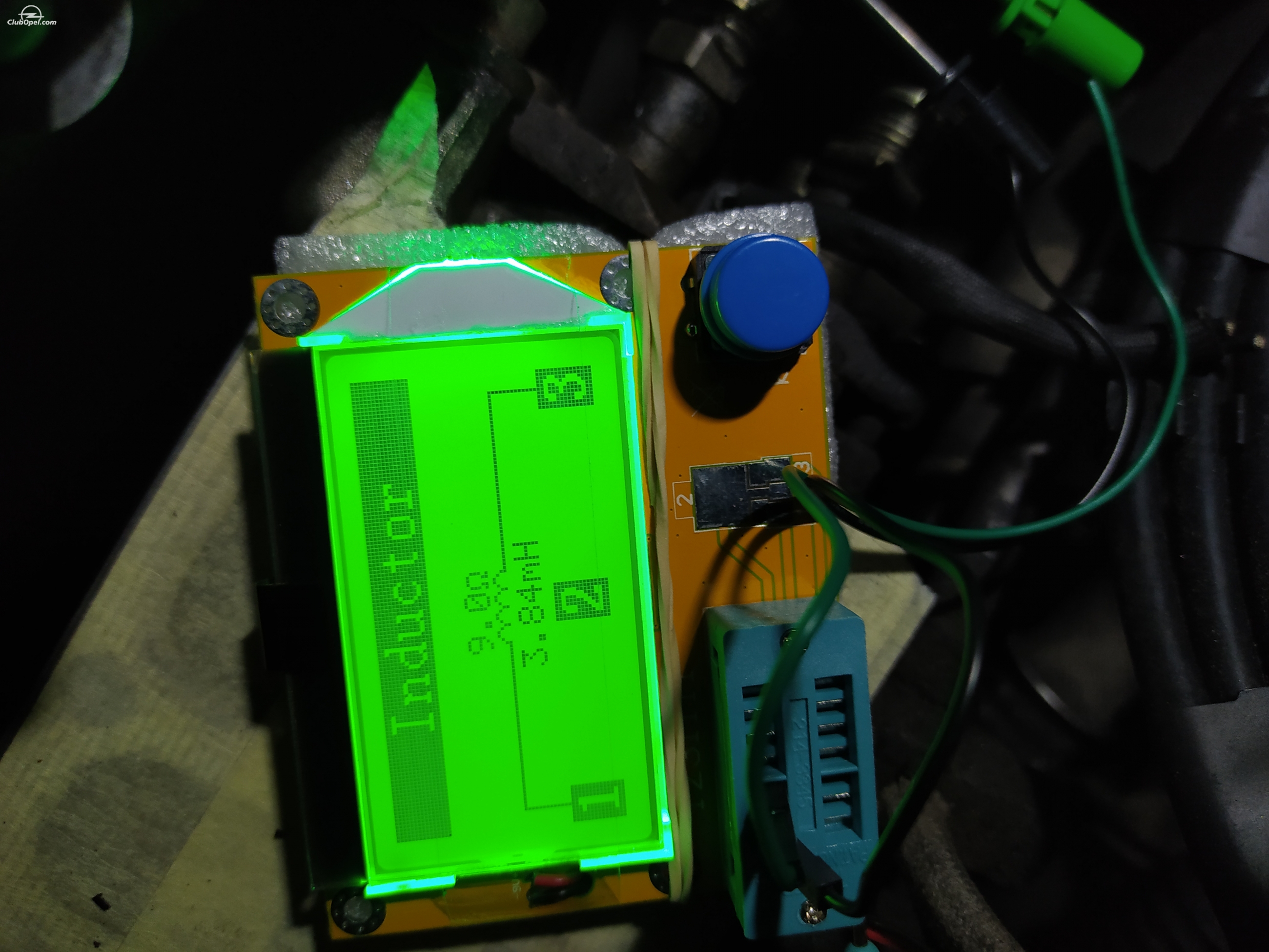

I did remove the sensor from its position because I had to repair the pump module - Voltage regulator was only giving 4.25V, and I was getting error codes:
P1651 - (B) CAN Receives Error - present
P1631 - (E) Injection Pump Malfunction 7 - present
I measured the valves when I had the module out and isolated their wires.
Only when I got to put everything back in place I didn't realize the sensor position was so critical.
I'm going to try to use the trick someone mentioned of centering the sensor using the marks left in the sensor body by the head screws.

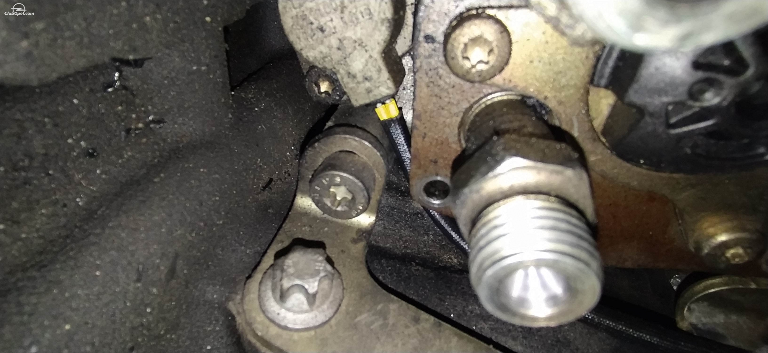

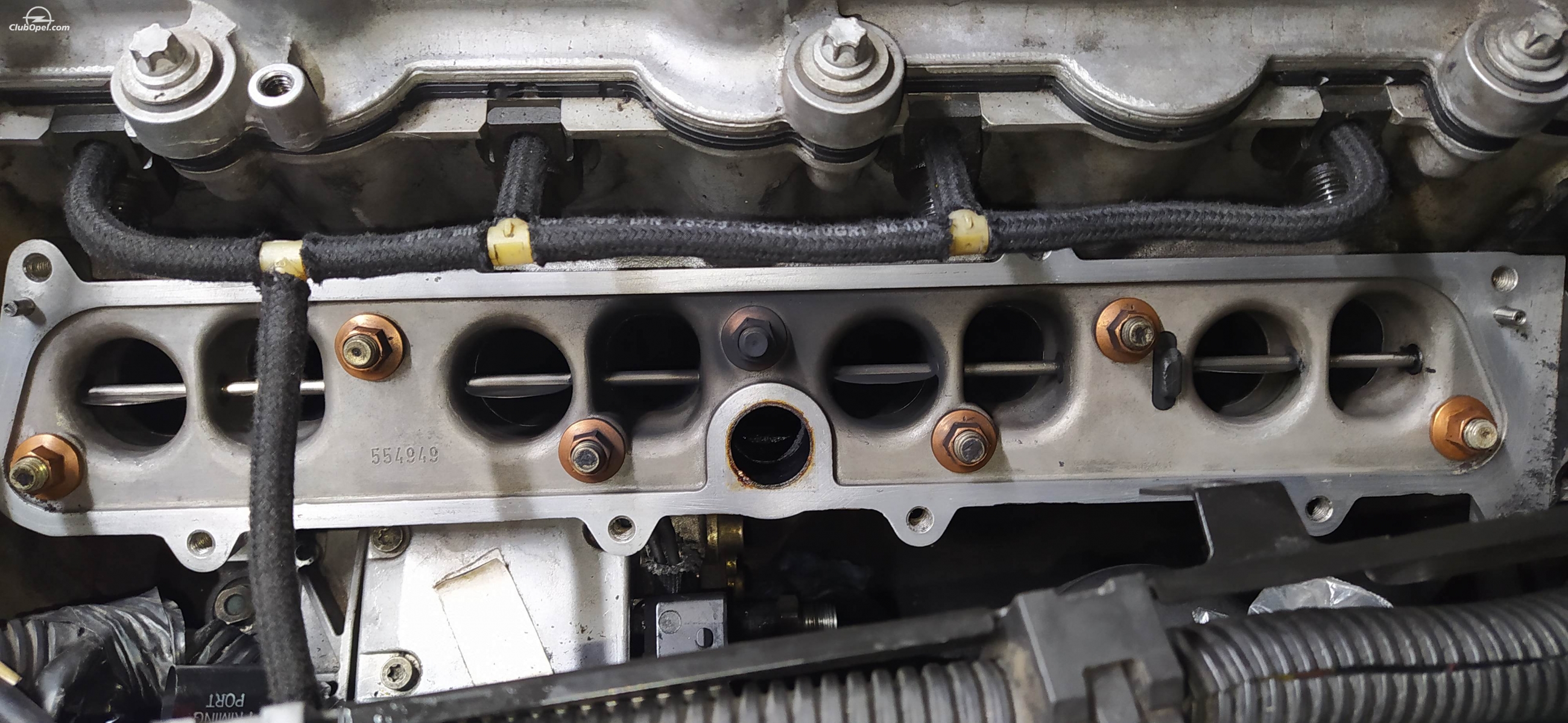

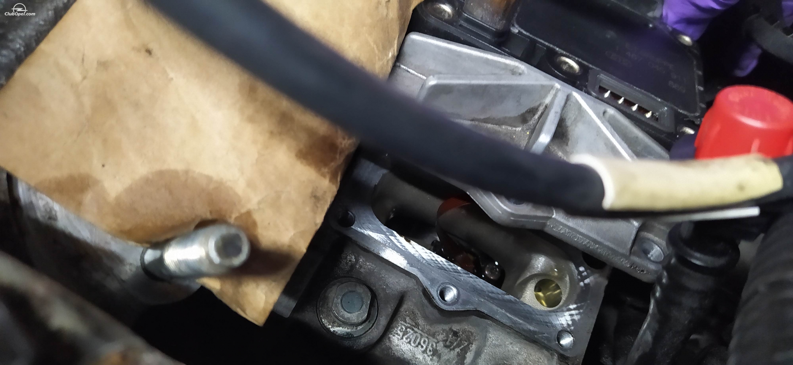

On the way to hell!
I no longer remembered that it would be so difficult to do this with everything in place.
That flat cable is scary!
